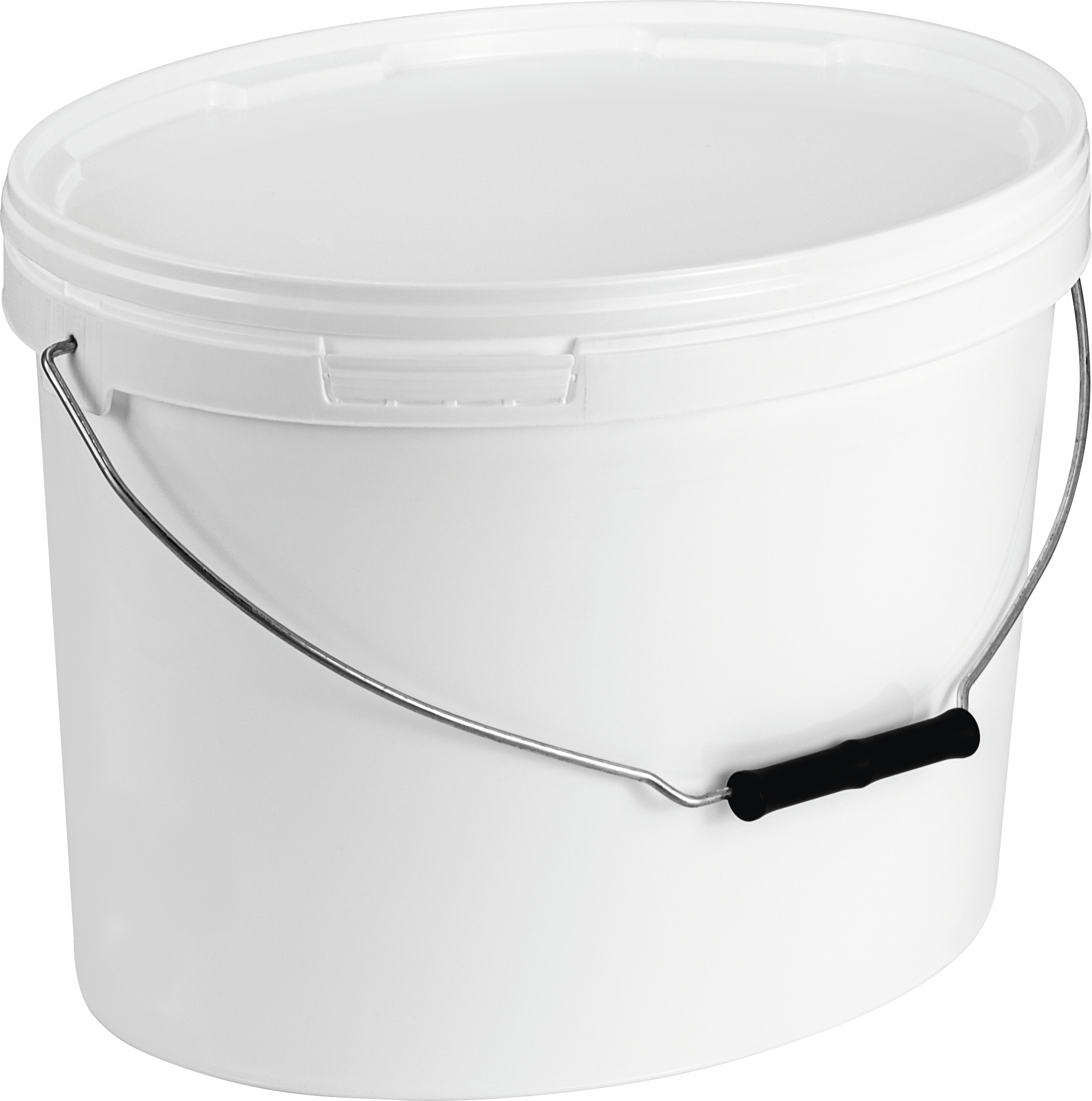

Type: Oval bucket Model: 11-1200 OV1 12.4 l
Food market
Chemical market
Download the specification
wymiary
Oval bucket  11-1200 OV1
DIMENSIONS / WEIGHT
Upper length (with flange):
340 mm
Upper width (with flange):
262 mm
Bottom length:
302 mm
Bottom width:
224 mm
Height:
237 mm (h)
Tolerances on dimensions:
+/- 1 mm
Total capacity (to edge):
13400 ml
Product weight (without handle):
358 g
Handle weight (plastic):
Handle weight (metal):
43,7 g (standard)
PP sleeve weight:
3,2 g
Weight tolerance:
+/- 5%
DECORATION
Dry offset
No
IML
No
Partial IML
No
Details included in the decoration templates.
Lid
Name:
P-12OV/Bis/2
Foiling:
No
Weight:
104 g
IML:
No
Offset:
No
Height with the lid:
239 mm
Capacity under the lid:
12400 ml
+/- 1 mm
Weight tolerance:
+/- 5%
RAW MATERIAL / TRANSPORT AND WAREHOUSING
Transparent packaging
Other packaging
Maximum batch weight:
kg
kg
Maximum load of the lower bucket:
44 kg
55 kg
The values indicated apply to ambient temperatures below 23°C.
Paletization
Arrangement on a 1200x800 mm pallet
Palletization at delivery:
500 pcs (packaging: hood or bag)
  • Material composition:
    Polypropylene PP ≥ 98%
    Dye ≤ 2%
    Other additives ≤ 0.5%
  • The packaging requires storage and transport testing in the environment of its intended use.
  • It is the responsibility of the customer to match the packaging with the target batch.
  • This guarantee is valid 12 months from date of delivery. During this time, the package should be used. All packages from a single pallet should be used immediately after unpacking.
  • All materials and dyes used to produce container or lid designed for the food sector are approved for food contact.
  • Packaging intended for direct and indirect contact with food (details include the Declaration of Conformity).
  • Manufacturer is not responsible for container deformation because of stacking of single pallets or putting on them an extra load.
  • The product is available in white, transparent or colored according to customer specifications. More colors
