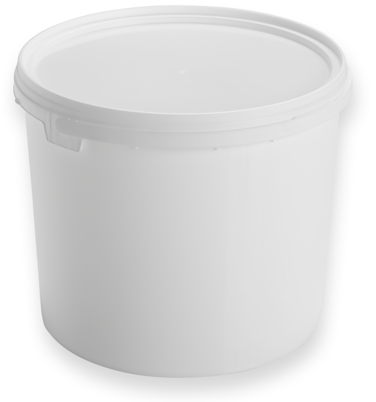

Round bucket lightweight 11-0500 LB3
DIMENSIONS / WEIGHT
Upper diameter (inside):
214 mm (b)
Upper diameter (with flange):
225 mm (a)
Bottom diameter (external):
193 mm (c)
Height:
187 mm (h)
Tolerances on dimensions:
+/- 1 mm
Total capacity (to edge):
5900 ml
Product weight (without handle):
140 g
Handle weight (plastic):
3,8 g
Handle weight (metal):
20,6 g
PP sleeve weight:
Weight tolerance:
+/- 5%
DECORATION
Dry offset
No
IML
Yes
Partial IML
No
Details included in the decoration templates.
LIDS
Name:
P-05FB/1
Foiling:
Yes
Weight:
40 g
IML:
Yes
Offset:
No
Height with the lid:
194 mm
Capacity under the lid:
5900 ml
+/- 1 mm
Weight tolerance:
+/- 5%
Name:
P-05LB/1
Foiling:
No
Weight:
32 g
IML:
Yes
Offset:
No
188 mm
5500 ml
+/- 1 mm
Weight tolerance:
+/- 5%
Name:
P-05LB/3
Foiling:
No
Weight:
32 g
IML:
Yes
Offset:
No
188 mm
5500 ml
+/- 1 mm
Weight tolerance:
+/- 5%
Name:
P-05LB/4
Foiling:
No
Weight:
32 g
IML:
Yes
Offset:
No
188 mm
5500 ml
+/- 1 mm
Weight tolerance:
+/- 5%
RAW MATERIAL / TRANSPORT AND WAREHOUSING
Transparent packaging
Other packaging
Maximum batch weight:
5.5 kg
5.5 kg
Maximum load of the lower bucket:
18.5 kg
23.1 kg
The values indicated apply to ambient temperatures below 23°C.
Paletization
Arrangement on a 1200x800 mm pallet
Palletization at delivery:
1080 pcs (packaging: hood or bag)
  • Material composition:
    Polypropylene PP ≥ 98%
    Dye ≤ 2%
    Other additives ≤ 0.5%
  • The packaging requires storage and transport testing in the environment of its intended use.
  • It is the responsibility of the customer to match the packaging with the target batch.
  • This guarantee is valid 12 months from date of delivery. During this time, the package should be used. All packages from a single pallet should be used immediately after unpacking.
  • All materials and dyes used to produce container or lid designed for the food sector are approved for food contact.
  • Packaging intended for direct and indirect contact with food (details include the Declaration of Conformity).
  • Manufacturer is not responsible for container deformation because of stacking of single pallets or putting on them an extra load.
  • The product is available in white, transparent or colored according to customer specifications. More colors
