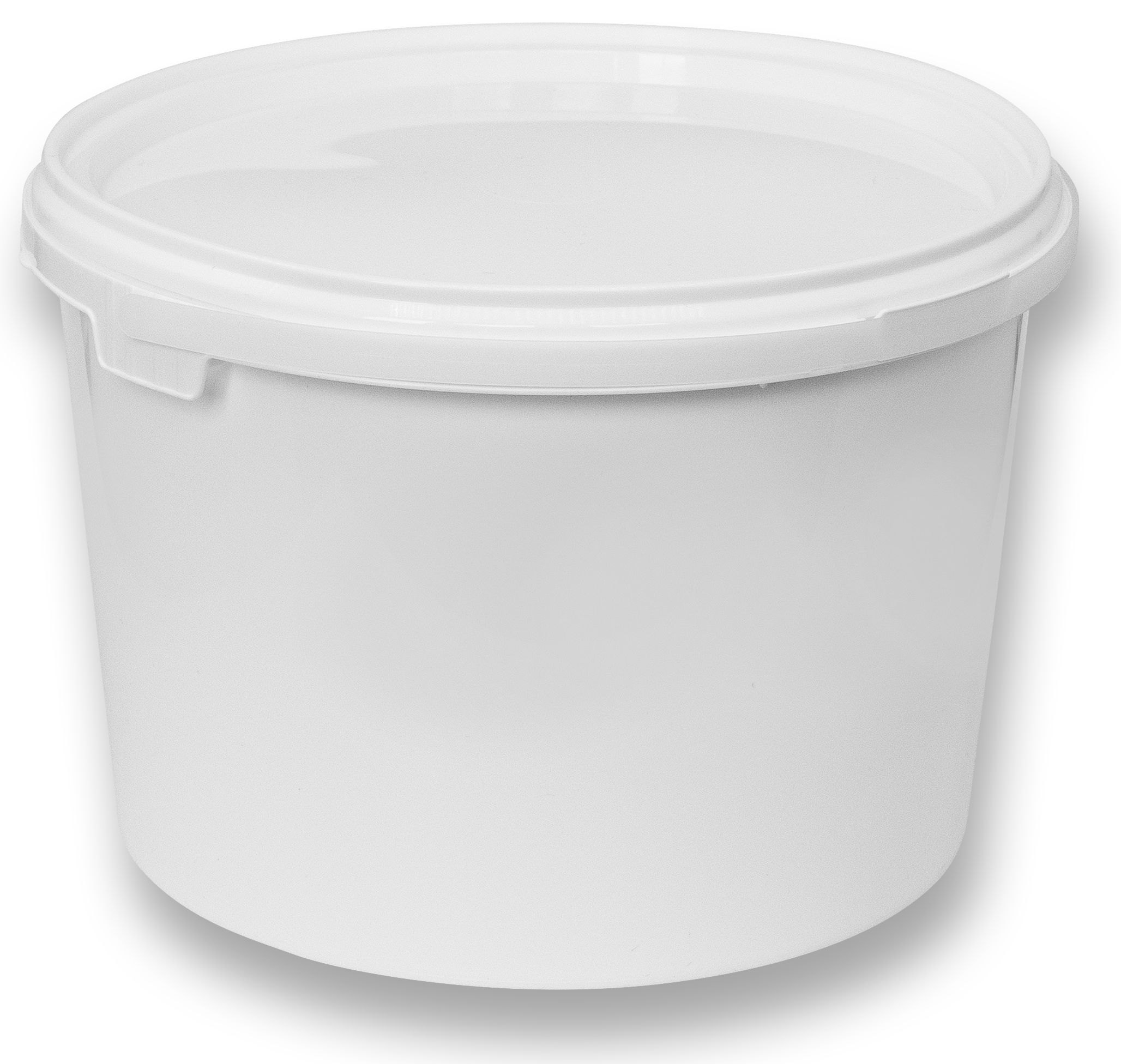

Round bucket lightweight 11-0280 LB
DIMENSIONS / WEIGHT
Upper diameter (inside):
188,8 mm (b)
Upper diameter (with flange):
200 mm (a)
Bottom diameter (external):
175,6 mm (c)
Height:
136 mm (h)
Tolerances on dimensions:
+/- 1 mm
Total capacity (to edge):
3300 ml
Product weight (without handle):
86 g
Handle weight (plastic):
2,9 g
Handle weight (metal):
PP sleeve weight:
Weight tolerance:
+/- 5%
