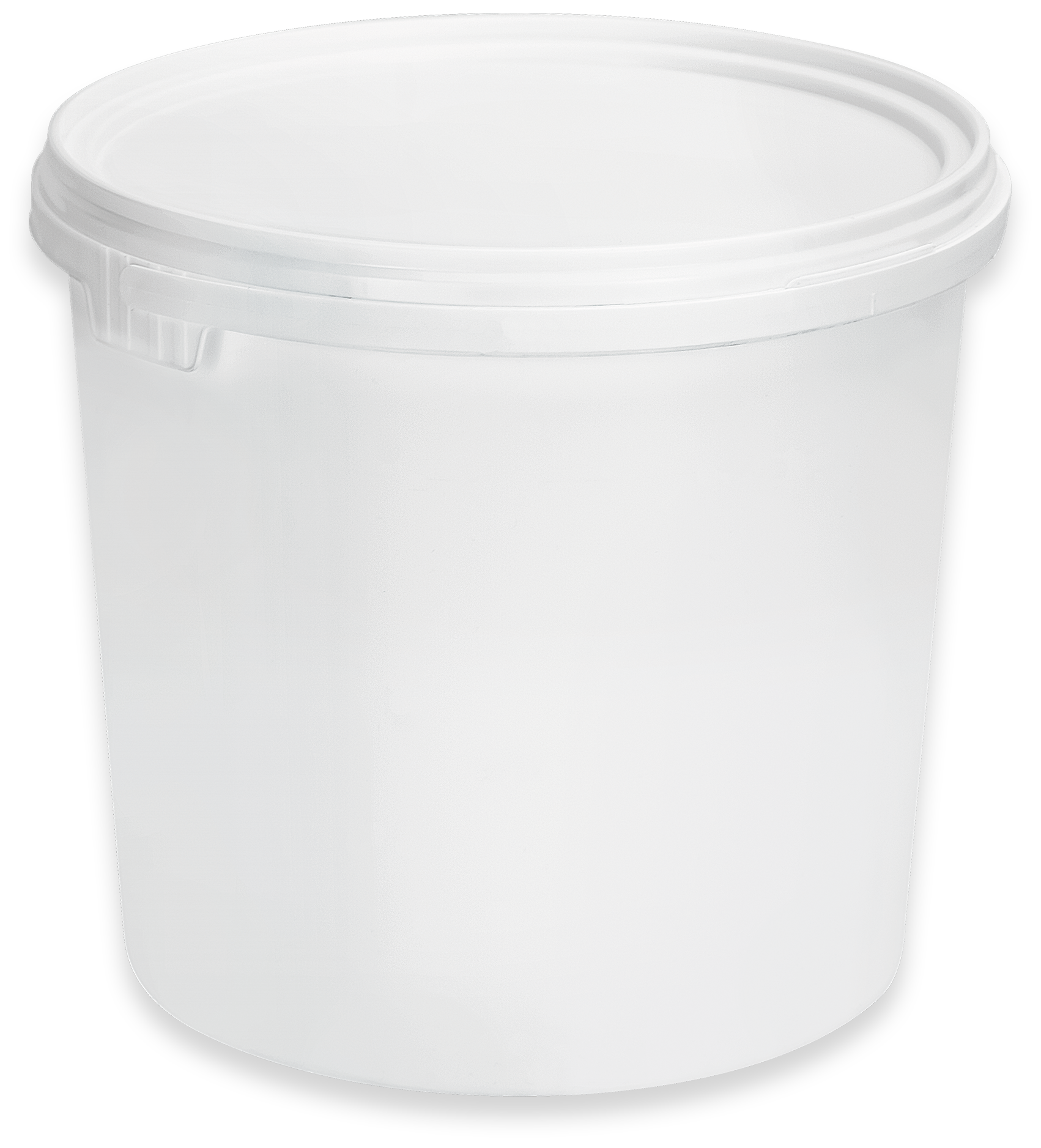

Type: Round bucket lightweight Model: 11-0275 LB 2.6 l
Food market
Chemical market
Download the specification
wymiary
Round bucket lightweight 11-0275 LB
DIMENSIONS / WEIGHT
Upper diameter (inside):
162,8 mm (b)
Upper diameter (with flange):
174 mm (a)
Bottom diameter (external):
144,5 mm (c)
Height:
156 mm (h)
Tolerances on dimensions:
+/- 1 mm
Total capacity (to edge):
2800 ml
Product weight (without handle):
76,3 g
Handle weight (plastic):
1,7 g
Handle weight (metal):
15,9 g (optional)
PP sleeve weight:
3,2 g
Weight tolerance:
+/- 5%

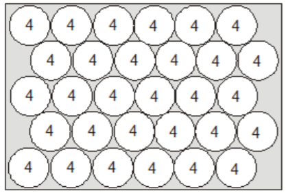

Paletization
Arrangement on a 1200x800 mm pallet
Palletization at delivery:
2220 pcs (packaging: carton box)
